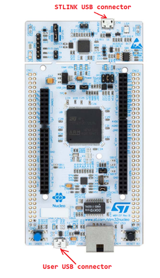

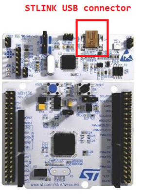

Referring to NUCLEO-F446RE UM there is no USB connector except ST-Link port.
How did you connect the USB device to your PC?
If you intended to use STLINK as your USB Device interface it will not work as this connector is dedicated to STLINK/Virtual COM. So you need to use another board for example NUCLEO-F446ZE:

In the first place, it is recognized as a virtual COM port in Device Manager.
We are using NUCLEO-F446RE.

2024-02-01 5:04 AM - edited 2024-02-01 7:39 AM
