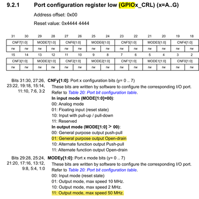

2025-11-14 11:16 AM
> GPIOB->CRL |= (0b0011 << (4 * 6));
This sets bits 0 and 1 of MODE6. It doesn't do anything to CNF6 which is 0b01 by default.
0b0111 is CNF6=0b01 and MODE6=0b11 which is open-drain output.
You want AF push pull, so 0b1011. You will need to clear bit 2.
