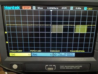

I work with Mihai Beffa, who started this thread. I managed to make some tests with the bad boards.
For context, the card is a slave on an I2C bus. Measuring the SCL line, I realize it can not be driven low enough by the master (don't go lower than 1.92V)
Decide to make the SCL (PA15) output push-pull (no I2C initialisation, no master connected) and toggle the pin with 1Hz. The pin goes from 1.36 to 3.3V. The resistance measurement between Vcc and PA15 has about 48 ohms for the bad microcontroller and a few megs on the good ones.

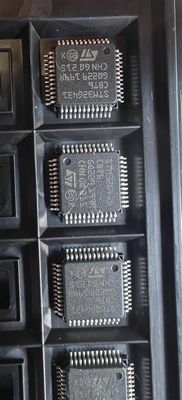

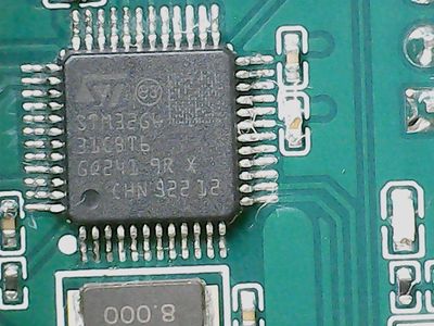

2026-01-06 1:39 PM
Here are the defective Microcontrollers:
And here is the new one we replaced with
