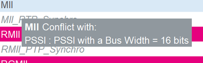

Hover over the red area to see why it cannot be enabled. In this case:
So pins being used by PSSI are the problem.

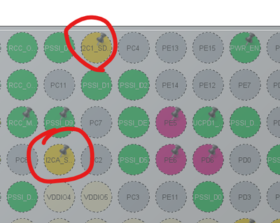

The nucleo board has a bunch of pins locked to various functions whereas with a new chip all pins are free. The locked pins restrict the amount of flexibility you have here. In this case, these pins are locked and are preventing you from using both.
In this case, these pins are the problem:
Reset their state (Click -> Reset State), then disable and re-enable PSSI and you can enable ETH.
