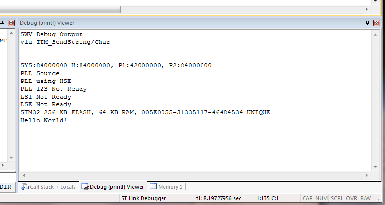

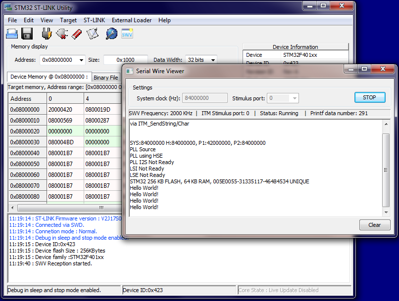

Building with 4.70 with library and project arranged thusly
C:\Keil\ARM\Examples\ST\STM32F401-Discovery_FW_V1.0.0\Projects\SWV-DEMOhttps://drive.google.com/file/d/0B7OY5pub_GfITVdTbF9iX0dLSkE/edit?usp=sharing

The CPU/Xtal selection are not critical, the memory allocation is important to the linker, and the CPU type (Cortex-M4) to the compiler.
The Xtal on the Discovery board is 8 MHz. It is the clock setting in the Debug/Trace pane that is critical to SWV support. The template project uses STM32F4_256KB, as of 4.71a there doesn't appear to be explicit support for F401 parts, they are nevertheless usable.2013-12-05 7:24 AM
