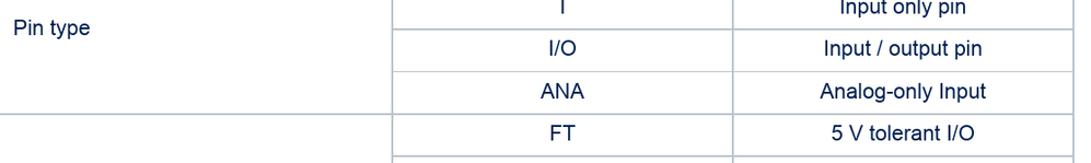

just from SWD connect 1,8 -> 3,3 V should be no problem, because pins 5V tolerant:

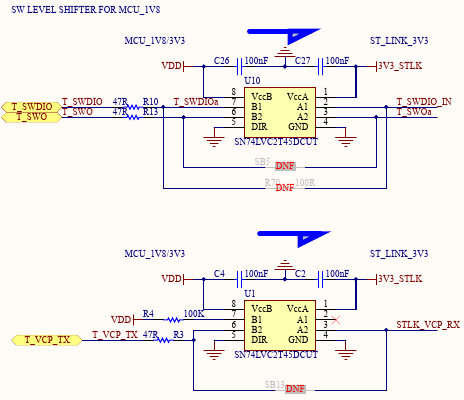

and from schema
https://www.st.com/resource/en/schematic_pack/mb1363-h7a3ziq-d01_schematic.pdf
nucleo144 has level shifters:
but NRST could be a problem... so should separate NRST pin. JP3 has to be open.

No problem encountered with Nucleo-H7A3ZI-Q with JP5 set to 1.8V, internal STLink and JP3 closed. Works like a charm. So your problem is most likely not directly related to the Nucleo boards but maybe to external circuit or power supply.
