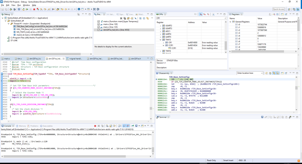

I am having issues when debugging STM32CubeMX for STM32F100RCT MCU generated project in Atollic. The ST-Link debugger jumps to unknown code location and generated HW fault exception. It happens with Cube generated peripheral INI HAL like TIM16, TIM17 and SPI1 as well. Usually in TIMx cases it happens when tmpcr1=TIMx->CR1; line in HAL {void TIM_Base_SetConfig(TIM_TypeDef *TIMx, TIM_Base_InitTypeDef *Structure)} function is executed. In the SPI1 failure case it happens when __HAL_AFIO_REMAP_SPI1_ENABLE() macro is called. I am using Cube App V4.21, FW V.1.4 and Atollic 7.1.2 Lite. Any idea? Please help.

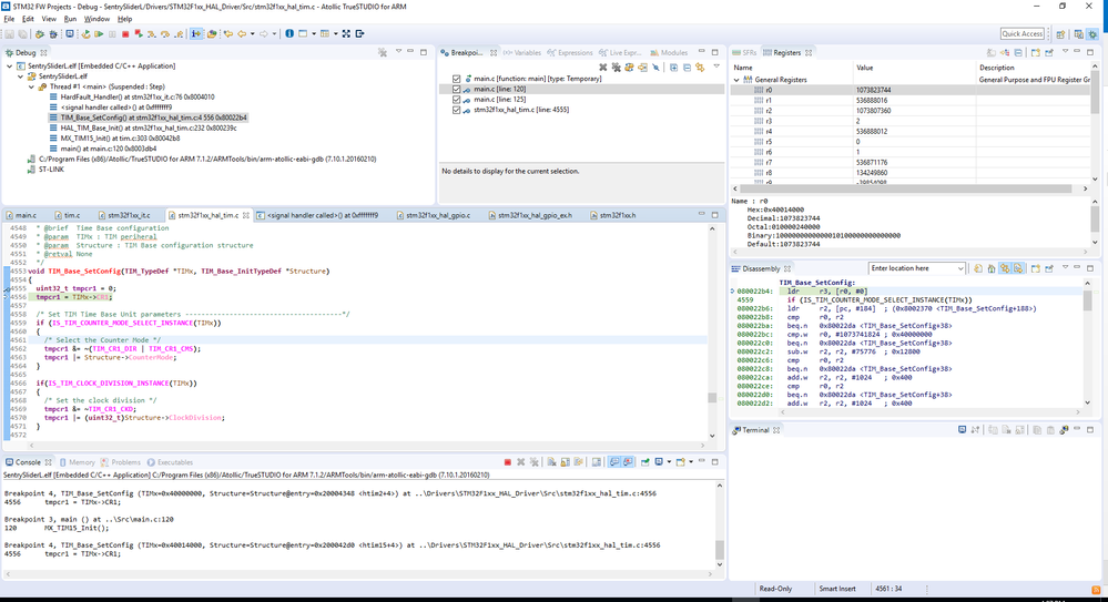

There is still a problem with TIMx
tmpcr1 = TIMx->CR1; line though (see attached screen shots, in this case is TIM15). The peripheral is re-mapped as well, and I saw the same remapping macro calling BIT_SET macro (is this a problem though?).R0 looks right (TIM15 base address) so I don’t understand what's going on.
Please refer this issue to STM team as well.
Thanks!

2017-06-22 1:47 AM
Hi All,
The issue of getting Hard Fault when executing
