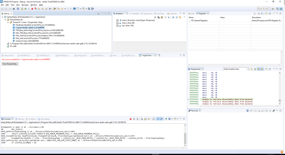

I am having issues when debugging STM32CubeMX for STM32F100RCT MCU generated project in Atollic. The ST-Link debugger jumps to unknown code location and generated HW fault exception. It happens with Cube generated peripheral INI HAL like TIM16, TIM17 and SPI1 as well. Usually in TIMx cases it happens when tmpcr1=TIMx->CR1; line in HAL {void TIM_Base_SetConfig(TIM_TypeDef *TIMx, TIM_Base_InitTypeDef *Structure)} function is executed. In the SPI1 failure case it happens when __HAL_AFIO_REMAP_SPI1_ENABLE() macro is called. I am using Cube App V4.21, FW V.1.4 and Atollic 7.1.2 Lite. Any idea? Please help.

My second suggestion would be to switch to disassembly (or mixed) display, and check the assembly instruction where you code goes 'off', and the SCB register contents (fault reason) afterwards.
2017-06-06 7:30 AM
Hi AvaTar, thanks for your advice. I have the optimization set to 'Optimized for Debugging (-Og)', debug level 'Maximum (-g3)' and this should be fine. Yes, I have used the disassembly window (see attached screenshot) and it says 'Unable to retrieve disassembly data from backend'. It looks like some portion of the code is missing or not been linked correctly. Unfortunately I can not pick up a clue how to resolve the issue.

Yes, I have used the disassembly window (see attached screenshot) and it says 'Unable to retrieve disassembly data from backend'. Unfortunately I can not pick up a clue how to resolve the issue.
Hmmmm, me neither. Seems an Atollic issue - not sure if 'backend' means GDB, which is usually run as separate process by Eclipse IDEs. One of the reasons this Eclipse stuff is second/third rate quality for me ...

...(see attached screenshot)...
I don't see any attachment ...
2017-06-06 7:58 AM
2017-06-06 8:04 AM
Ahhh, that is ok.
I (implicitly) meant the assembly context of the function
TIM_Base_SetConfig()
, where crash to the hardfault handler happens. Especially those immediately before.2017-06-08 1:24 AM

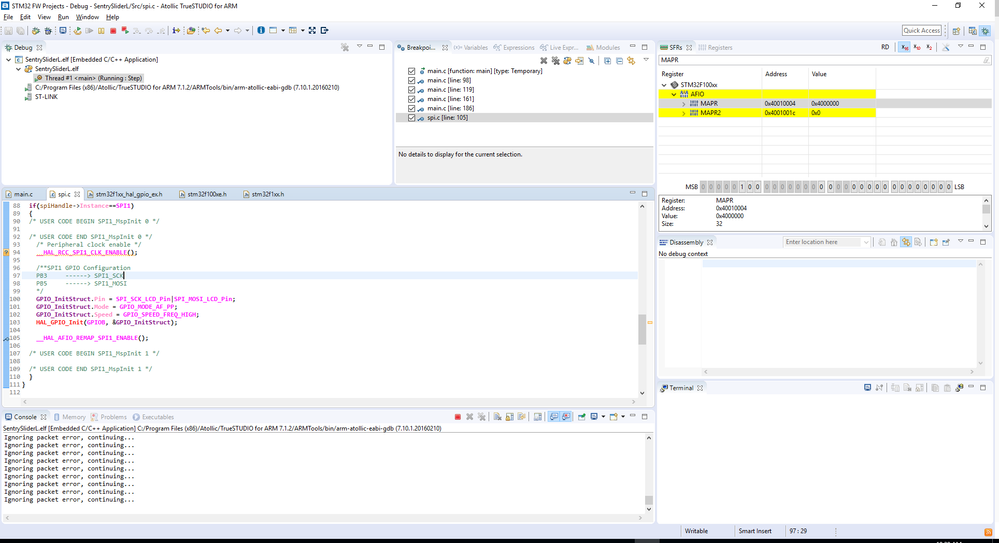

Hi All, in the case of ST-Link freezing when
__HAL_AFIO_REMAP_SPI1_ENABLE() macro is called:
The error message is:
warning: Remote failure reply: E31
As a matter of fact the re-map of SPI1 affect AFIO-MAPR register where SWD re-mapping bits are located as well.
Could that be the problem?

As mentioned before, I don't know the Cube code, and certainly not this macros.
But I remember that old adage 'The macro is a coder's declaration of capitulation'.
I suggest you 'statically code-review' this macro, or switch to disassembly in the debugger and check it's execution.
Might well be, can't recall the MCU specific context here.
At least none of the SWD pins and SPI1 pins share a GPIO directly. Perhaps the macro kills other AFIO config bits as well.
2017-06-08 8:04 AM
Guys, there is a bug in STM32F100 HAL remapping scheme when SPI1 is remapped. __HAL_AFIO_REMAP_SPI1_ENABLE() macro is extended to SET_BIT(AFIO->MAPR, AFIO_MAPR_SPI1_REMAP) and further to #define CLEAR_BIT(REG, BIT) ((REG) &= ~(BIT)) macro, which is Read-Modify-Write. Non valid data are read for MAPR SWJ_CFG bits, and sub-sequentially written back to MAPR. In most of the cases the debugger configuration is corrupted and the debugger hangs on. Work out: replace the macro with Read-Modify-Write one where you explicitly cast your debugger mode. In my case is SWD, see the solution below:
