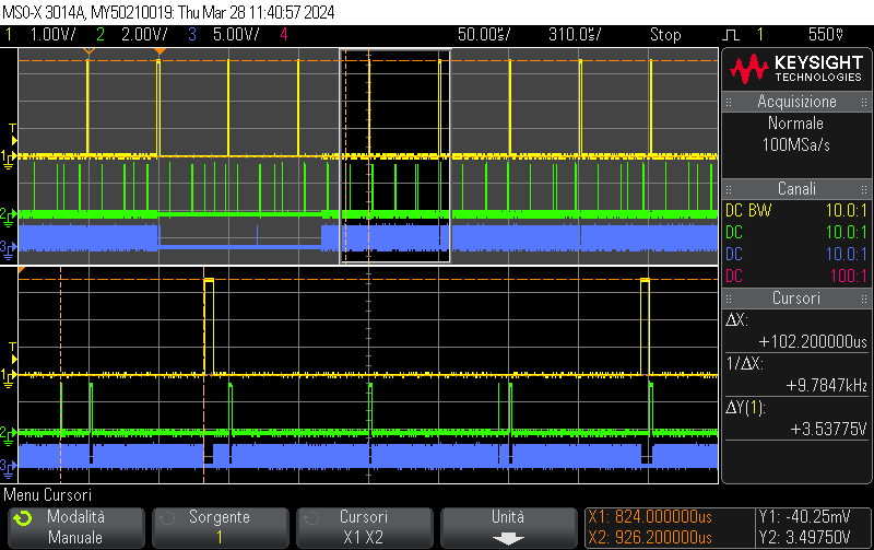

TIM1 trigger has even a interrupt that rises and falls a pin (oscilloscope green)
GPDMA1_Channel1_IRQHandler rises and falls a pin (oscilloscope yellow)
Time interval between green and yellow tracks on oscilloscope is very good = (17+20) / 16MHz * 12smpl * 4ovs = 111us = time between the start of conversion sequence from timer and the transfer complete, of 12 samples, of the DMA

2 - The time between oscilloscope green and yellow tracks change every debug comunication (for example enabling and disabling the previous mentioned breakpoint, which never hit). Add theese are the oscilloscope time lapses sequence i registered between the two tracks: 111us,102us,19us,65us,74us,83us,19us,102us,74us,102us,65us,102us,65us,102us,102us,102us,46us,111us....and it goes on ramdomly.
Theese intervals however seem to be displaced every about more or less 9us apart and when the interval is randomly back to 111us the ADC value is no more halved but is correct.

THE PICTURE ABOVE: yellow=dma interrupt handle every 12 samples sequence transfer complete; blue=toggle when idle in the while(1) loop; green_1=every 100us interrupt from TIM2; green_2= TIM1 triggers (every 312.5us) the ADC for a sequence. In this example picture please note cursors DeltaX=102us.
