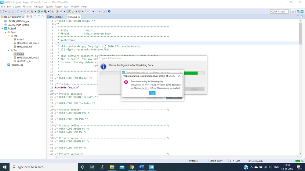

Dear Sir,
Debug and driver folders are not created in code generation
Debug option is also not highlighted in menu button.
Below is the screenshot of that
please help.

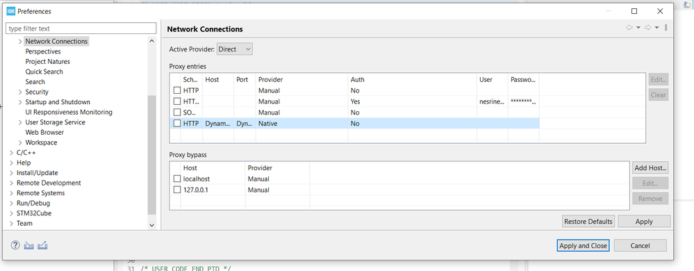

Hello @Byede.1
Tested the same scenario without getting issue.
I would like to know if you use a proxy or not because; if you don't use a proxy, with Direct and Native, you don't have to fill in the fields (you have to leave them all empty), on the other hand if you use a proxy, you have to fill in HTTP and HTTPS.
Best regards,
Nesrine
2020-11-23 6:31 AM
2020-11-23 6:38 AM
Hello @Byede.1
Go to window ==> preference
Best regards,
Nesrine
