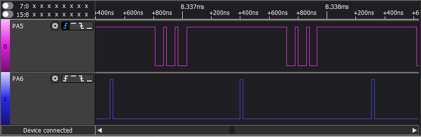

Ha OK,
Thank you.
And is there the same phenomenon when propagating the interrupt signal?
Because in this example, it appears that the code is not immediately interrupted when the reason for the interruption appears (rising edge of the first pulse).
(The PA5 output is connected to the PC1 input).
Thanks again in advance for your help.

2020-11-07 5:06 AM
Yes that's exactly the same.
When interrupt is exit, PA5 in main() starts to pulse again, and the first active edge (depending on which edge is set in EXTI) sets the interrupt flag in EXTI; but it takes 2 more PA5 pulses (i.e. estimating pulse to be high for 1 system cycle and low for 3, it's at least 8 system cycles) until that signal propagates all the way to NVIC and starts the interrupt.
A very nice visualisation of the problem indeed, thanks.
2020-11-07 6:35 AM
Thank you.
Actually I am in the process of migrating from avr to arm ... so I am studying this core .
Just for information, the 3 cycles of the low state are actually 1 cycle + 2 cycles of sequence break (1 cycle of jump + 1 flush of a 1/3 of the pipeline). I had actually estimated 8 cycles but I am continuing my study to get a more deterministic answer.
Thank you again for your clarifications. I had not yet studied the bus times well.
