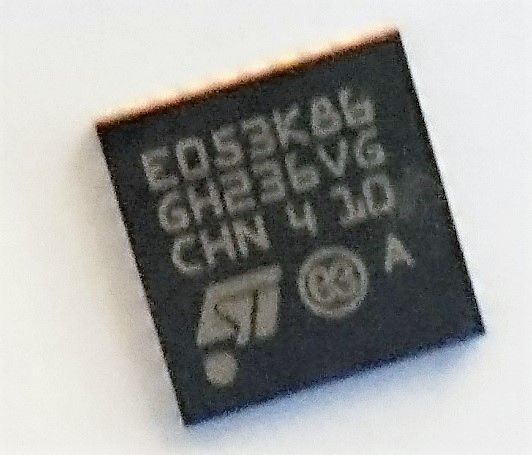

I recently got STM32L053K8U6 from Arrow Electronics. I am very surprised as I couldn't find the datasheets/technical documentation of STM32L053K8U6 . I believe STM32L0 series MCUs have 10 years longvity commitment. Even if it is discontinued the datasheets must be make available in archives. Arrow Electronics website did not mention anything about its status like EoL.

That's it - the E053 marking instead of L053 tells that these are engineering samples.
Thanks for the picture. JW2016-11-15 6:13 PM
Hi Jan, I was just wondering, as these are Engineering Samples, why is Arrow.com selling them in the first place and that too with wrong information on their webpage?
