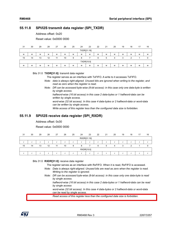

Oh, it's in the fine-print, indeed:
2023-04-18 7:32 AM
STM32H757's reference manual is RM0399 (screenshot comes from RM0468).
Seems like they should add this line to the RM0399 too.
2023-04-18 10:08 AM - edited 2023-11-20 9:13 AM

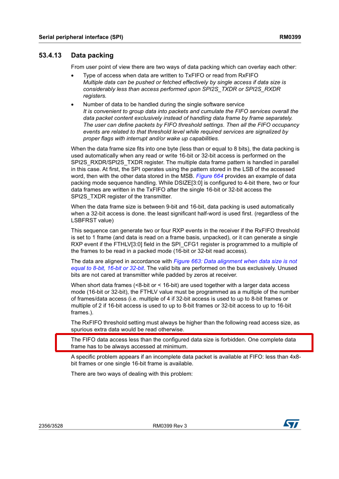

Humm, what a lucky choice of RM to find such a particular remark...
Current RM0399 is rev.3 dated 27-Feb-2020, the remark probably appeared in some of the later revisions of RM0468 i.e. in 2021. All these while deeply in The Big Parts Shortage, so probably nobody complained yet. I guess a newer revision of RM0399 will contain it, but who knows when will such revision appear.
It's not uncommon that for newer informations or even errata you have to browse through other RMs, ST does not issue updated RM/ES regularly.
