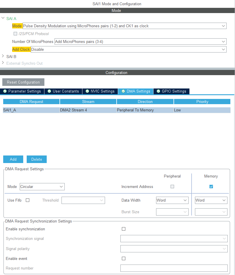

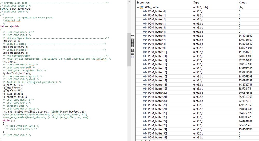

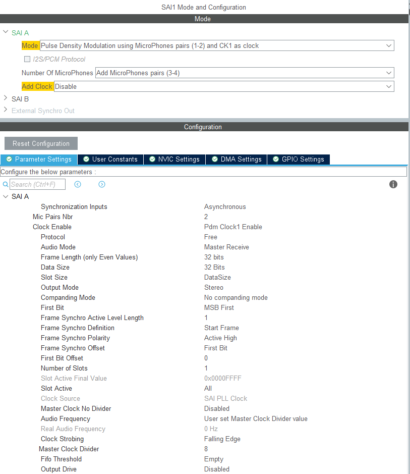

I have configured the readout of 4 PDM microphones through the SAI interface. I am using 1 slot of 32 bits per frame.
I have enabled DMA.
Unfortunately, when reading PDM data, the first 6 and last 2 values of the array are filled with zeros. This happens regardless of the size of the PDM_buffer.
Do I have something misconfigured? What could be the cause?
Edit: If the PDM_buffer array is of type uint16_t, there are 2x more zeros (12+4 ), and in the case of uint8_t 4x more zeros (24+8).

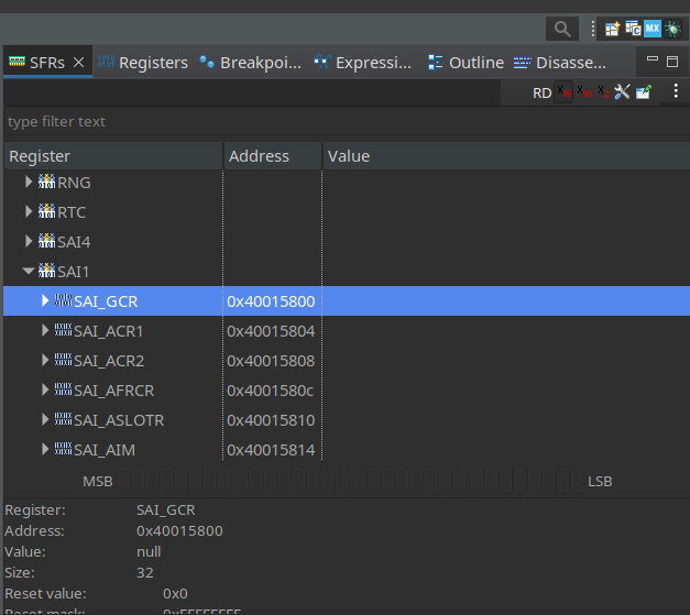

How can I read out content of DMA and SAI registers?
I work in CubeIDE and HAL library.
Edit: I have tried the first solution from the link and it doesn't work. Tomorrow I'll check the second one.
2023-02-26 12:17 AM
in debug (when paused) -> SFRs
can see all peri. registers

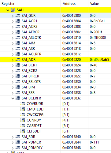

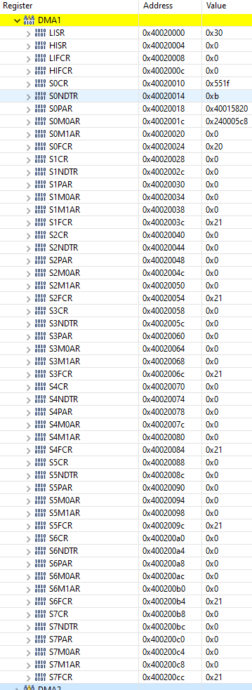

2023-02-26 2:21 AM
SAI and DMA registers:
2023-02-26 4:23 AM
To see proper register values, I had to pause and resume debug process.
S0NDTR and SAI_ADR change after every pause.
