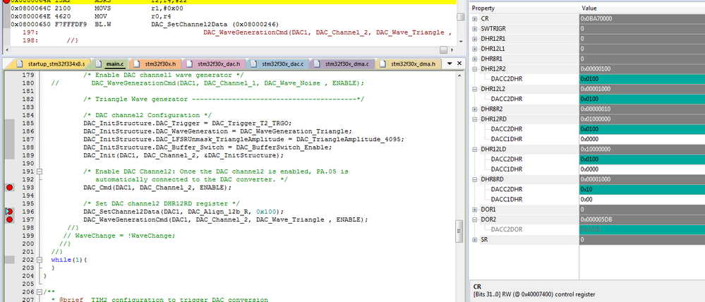

Hi again,
In my never-ending quest to understand the registers, I try some changes in the code I had to output a triangle waveform from DAC channel2 on STM32 F334R8.I have several questions.- I use PA_05 to output my signal, it corresponds to DAC1_OUT2, but also, refering to thehttps://developer.mbed.org/platforms/ST-Nucleo-F334R8/
,to LED2. It is configured as analog output, so I thought it was okay, but I can see a faint green light from the LED. Is there a leak or a flaw of any sort in the configuration? I'm pretty sure it is not supposed to glow even faintly if I don't ask it to do so.- My code is supposed to send 0x100 as data (even though I have no idea what does it mean) to DHR12RD, but when I look into the registers, the value has been written pretty much everywhere. Why? Again, is there some flaw in my code?EDIT:
