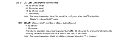

I am in desperate need of your help. I am trying to extract audio from an INMP441 microphone using a Nucleo STM32F4RE11 and store it as a WAV file on an SD card. According to the datasheet, the microphone outputs signed PCM 24-bit audio in MSB-first order, wrapped in a 32-bit frame.
To handle this, I have configured the I²S "Data and Frame Format" to "32 Bits Data on 32 Bits Frame", attempting to extract the 24-bit data from the 32-bit frame and convert it to Little Endian format. However, I am facing issues with the extracted audio:
  • While I can recognize my voice's timbre, the amplitude is extremely low, and the waveform appears very weak.
  • When I previously tested "16 Bits Data on 32 Bits Frame", my voice sounded unnaturally deep, almost like a male voice.
I suspect there may be an issue with my bit extraction or size allocation. Here's a brief summary of my setup:
  1. I declared an int32_t variable to store the raw I²S data and used the following function to record audio:
    HAL_I2S_Receive_DMA(&hi2s3, (int32_t *)data_i2s, sizeof(data_i2s)/4);
    However, I am concerned that this might be incorrect since the function prototype expects a uint16_t * pointer. Given that I’m handling int32_t data, I’m unsure of the correct way to manage this typecast.
  2. For extracting the 24-bit data, I have performed bit-shifting and swap the bytes to store in Little Endian format, but I’m not sure that I’ve done it correctly because the extracted audio I got is so low.
I have attached screenshots and code snippets for better context. I would greatly appreciate any insights on how to debug this issue.
Thank you so much!

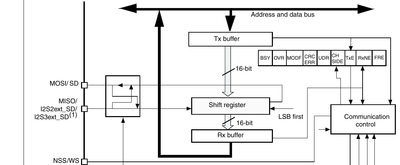

SO on F411 now - this has no SAI.
And on 32b frames i had some problems onmy tests with F411, i concluded: here 32b mode never working  as it should - but seems, no problem, almost not used by users.

I checked in rm, F411 can :
24b in 32b frame - can be set. Just test, its really working correct...

Thank you so much for your suggestion. I have been trying in vain with 32 bit in 32 bit format. I want to try out 24bit in 32 bit frame but I don't know how I should declare the type of variables and extract the data, because there is no int24_t variable right? :(( Do I have to store the variable in 32 bit in 32 bit frame then extract 24 MSBs?
Right, to work with 24b data, its obvious to store 32b , int32_t .
So your data is just a int32 , no shifting together needed.

- the spi/i2s on F411 can handle only 16b in its shifter :
- (it might not work correct...at least: i didnt get it working always (!) correct with 32b data )
- set I2S to 24b in 32b frame
