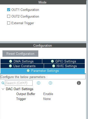

this is configuration image
2021-03-23 1:57 AM
2021-03-23 2:10 AM
