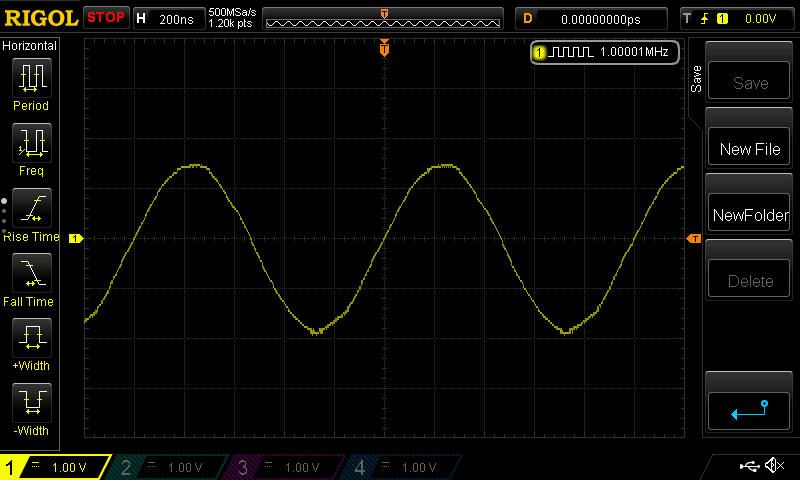

The DAC does output a reasonable 1 MHz sinewave. It isn't a pretty one as it is constructed by just 7 samples from the sinewave-table.
2019-09-24 9:08 AM
See the image I uploaded. I don't think the DAC is overclocked. The datasheet states "Max frequency for a correct DAC_OUT change when small variation in the input code (from code i to i+1LSB)" So I cannot complain with ST when the output isn't correct anymore.
The load of the DAC is 0 (zero) ohm as it is connected directly to the negative input of the (external) opamp with the positive input on (virtual) ground. Therefore there is no problem with any capacitive loading. (see AN4566)
