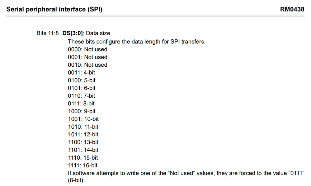

If you're looking for info, the reference manual is usually the best source.
> My question, is there any easy way to get 18 clock pulses using the existing cube IDE and HAL functions?

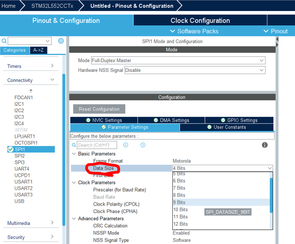

The SPI module in the L5 can be set to have a word size anywhere between 4 and 16 bits. Using 2x 9-bit words will get you to an 18 bit transaction size.
These are settable in CubeMX:
