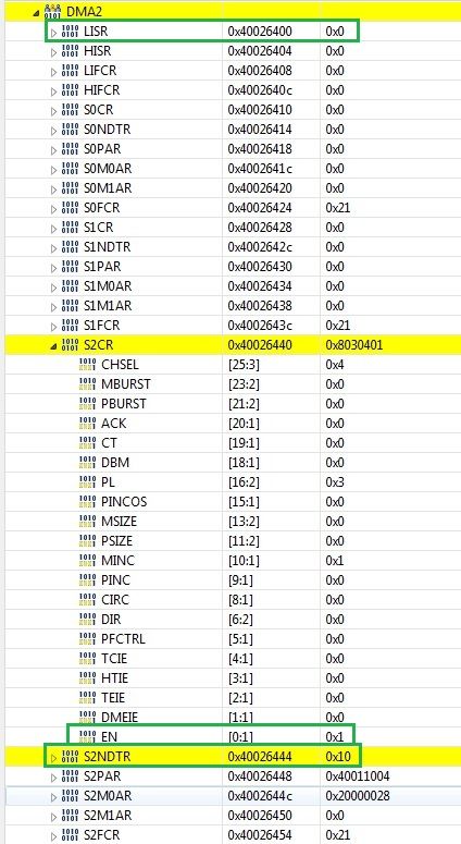

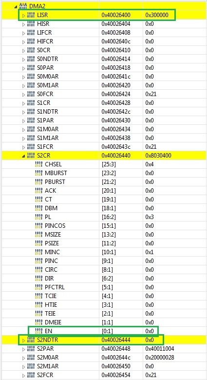

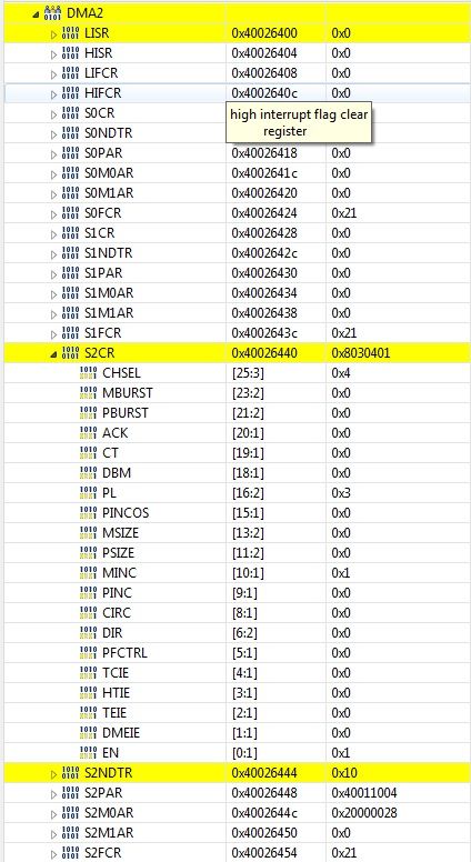

DMA_SxCR_MINC;Here is a screen snapshot of the DMA registers.
To me, this appears to be setup correctly, and is ENabled.

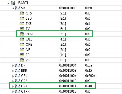

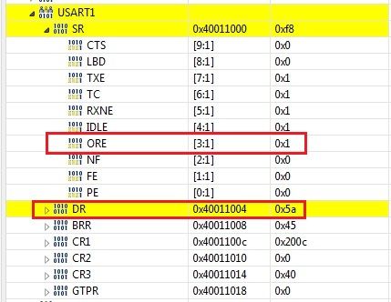

USART1 registers when program was stopped.
Received data is 0x5A, but was never transferred to memory.
DMA doesn't ever appear to transfer data from USART1->DR to buffer memory in RAM.

2021-12-04 2:17 PM
You need DMAR set in USART_CR3 in order to trigger the DMA transfer on RXNE.
You do not need interrupts enabled.
Note that reading DR in a debuggers will reset the RXNE flag.

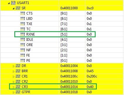

Here are the DMA and USART registers before the first transfer.

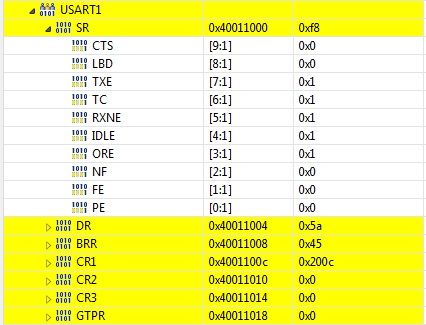

Here are the DMA and USART register immediately after the first transfer.
The DMA register are what I would have expected. However, the USART registers were a bit of a surprise in two instances.

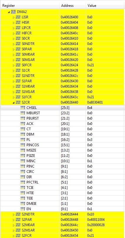

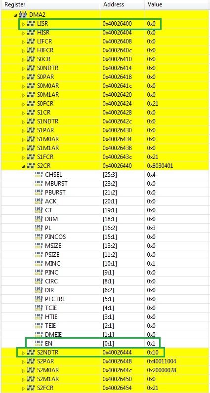

Here are the DMA registers immediately before the 2d transfer is attempted. They are identical to registers before the 1st transfer was made.
They appear to be setup properly,as expected, and ready to go.

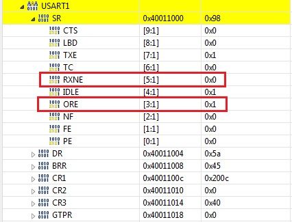

Here are the same registers after the 2d DMA transfer is attempted.
The DMA registers appear to show that no attempt was made to transfer data - the counter remains at 0x10. Also was somewhat expected that if no data was attempted to be moved out of the USART data register that there would be a data over-run. However, the RXNE flag does not show that any data was received.
This last result is especially puzzling to me. I know that data was sent because I capture it on a logic analyzer each time.

If ORE is set, you're receiving characters that aren't being read by your code or by DMA.
You're not setting the length of transfer NDTR anywhere in your "test code loop". Starting DMA with NDTR=0 won't work. It's at 0 after the first transfer completes.
USARTx->SR = 0 doesn't clear all bits, only a subset of them.
2021-12-05 10:51 AM

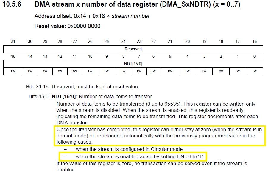

At one time, I was setting the NDTR register to the desired count in the test loop. However, I came across this note which states that the NDTR is reloaded automatically with the previous value when the DMA is re-enabled. So I took that statement out of the loop.
You are spot on about the ORE flag being set, and that is really my point. This flag shouldn't be set at all if all the bytes had been read by the DMA, and they appear to have been read because they are in the buffer, but here we are with the ORE flag set at the end of the first transfer, and only 16 bytes were sent. ???

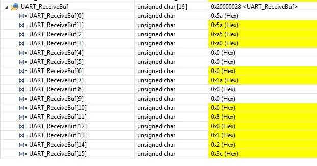

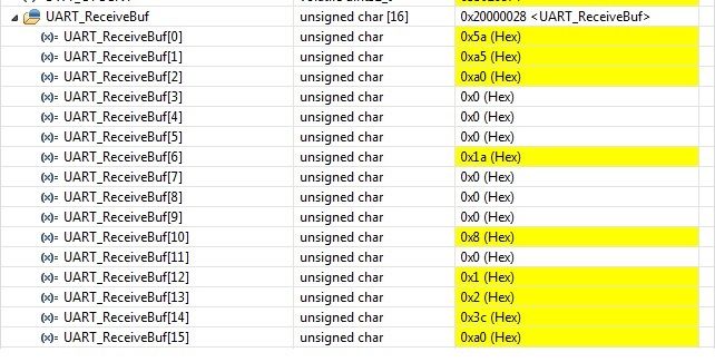

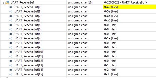

}It appears as if disabling the DMA for USART1, the re-enabling caused some sort of problem where the DMA would only work once. Now the DMA triggers every time, but there is another problem.
The values in the ReceiveBuf are correct the first time through (value and location). But they are shifted by a byte from then on.
First time is correct.
Second time. First value is wrong, and all others are shifted by a byte.
Third time. The actual last byte received from the last message (0xA0) is in the first byte position. All others shifted down.
Nowhere in my test loop have I changed the source or destination pointers, or even the count for that matter due to the auto-reload.
