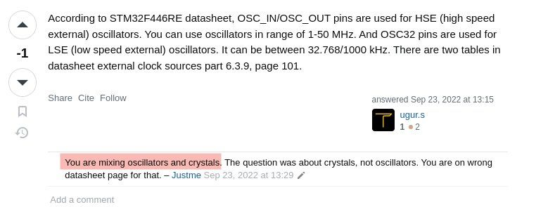

Newcomers often make the mistake of conflating the terms "crystal", and "oscillator". For example, see @Andrew_Neil 's multiple comments on this thread, where he does his utmost to banish this common error.
Quite recently, I made the same mistake when asking for help finding a low-power clock source.

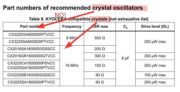

AN2867: Guidelines for oscillator design on STM8AF/AL/S and STM32 MCUs/MPUs
mixes and shifts between related terms multiple times in its 59 pages. The resulting confusion is enormous. Instead of working to remove confusion, ST's documentation contributes to it:
which is followed immediately by
Dear ST, please flag this AN for review and urge the documentation team to be absolute tyrants about correct usage.

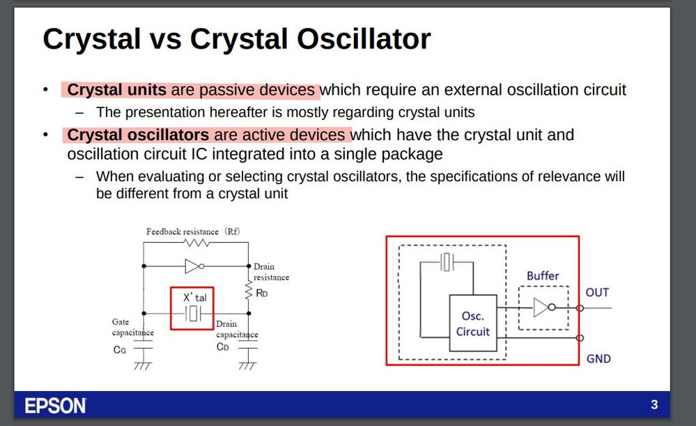

2024-06-29 10:52 AM - edited 2024-06-29 10:56 AM
From [EPSON] Crystal Fundamentals & State of the Industry :
If ST writers lack a catch-all term, perhaps "Frequency Source" would do, instead of randomly selecting one of the three (crystal, oscillator, resonator) on each occasion. Including a glossary placed at the start of the appnote would enhance clarity as well.
