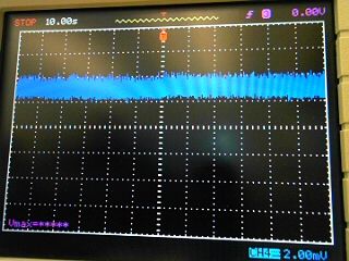

I measured the current consumption of STM32F3 discovery board from its Idd pin and I always see the current consumption decreasing with time over a period of 50-60 seconds and then shoots up to the initial value. I used a standard example from ST STM32F3-Discovery_FW_V1.1.0\Project\Peripheral_Examples\ADC_Example and tried putting a while(1); loop as the first line of main().
I have found the same effect on STM32f373 MCUs as well. Can someone tell me the reason for that and how to rid of this saw tooth behaviour? Please find attached the screenshot of the behaviour from the oscilloscope. #stm32f3 #stm32f3discovery2015-02-24 7:03 AM

What is the absolute value of current consumption and what is the amplitude of the ''sawtooth''? The period is around 55 seconds, correct? If I understand what you wrote about your code correctly, the ADC module is running, but conversion is not started if you placed an empty while(). What happens, if you omit the ADC initialization altogether and place only an empty while()? [EDIT] on second reading of your initial post, it appears that this is exactly what you've done already... that would leave HSE+PLL as the only possible source of disturbance(?) Try various clock options (HSI alone, HSI+PLL, HSE alone, HSE+PLL, various PLL settings, external clock), any change? Another idea, can't this be some artefact from the used power source under the increased load when PLL is running? Try to add some artifical load while mcu is in reset. Btw. did you disconnect the SWO lines from the debugger 'F103? JW2015-02-24 8:16 AM
Hi waclawek.jan,
The absolute value of current varies depending on what peripherals I enable. Currently, when no pheripherals are enabled, the current consumed is roughly 3.15mA with amplitude of 72µA for the saw-tooth. On the scope (Rigol DS1204B) the blue signal is a measurement with a current probe (Agilent 2005, PowerSupply N2775A) , the factor is 40 and the result is in mA. Yes, the period is 55 seconds. The ADC is not even initialized! It is like:int main(void)
while(1); ...
} Only the startup_stm32f30x.s code should run. I just took a sample project from the ST example as I have seen the same effect in my code which is an entirely different project. I've also made the measurement without ST-LINK (please see the picture attached).

Yes, HSE+PLL is the only possible source of disturbance as far as I know. Currently, We are using 72MHz and we are not interested in other clocking options for my application. I'll try the same with the STM32F4 dicovery board and let you know the result. Thanks. Riz2015-02-24 9:31 AM
