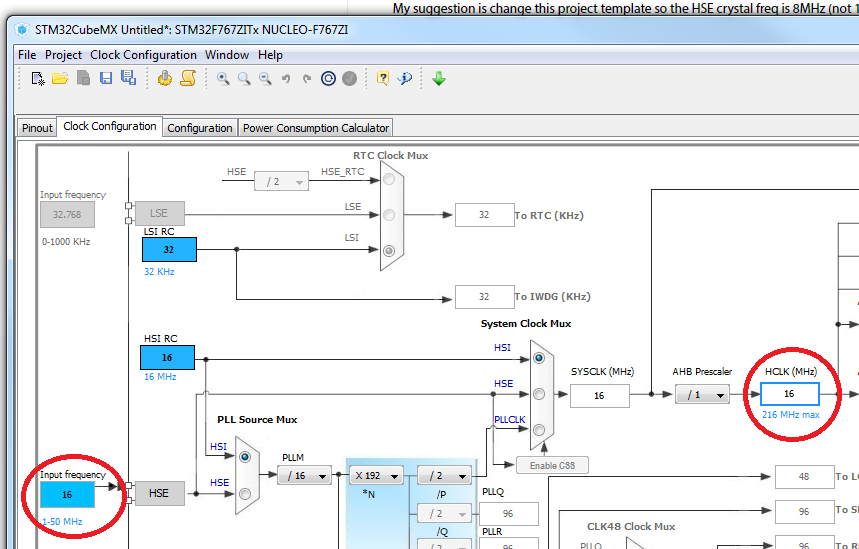

If you create a Cube project using the NUCLEO-F767ZI board template, it uses 16MHz for the HSE crystal.
Out of the box, from the user manual, the dev board uses the:
MCO from ST-LINK (Default): MCO output of ST-LINK is used as input clock. This
frequency cannot be changed, it is fixed at 8MHz and connected to thePF0/PH0-OSC_IN of STM32 microcontroller. The configuration must be:– SB148 OFF– SB112 and SB149 ON– SB8 and SB9 OFFThis minor issue will probably get a few users scratching the heads like me when they cant get the correct baud on uart or other. But this is the only NUC/Disco board i have used where the template doesn't work for out-of-box boards.
My suggestion is change this project template so the HSE crystal freq is 8MHz (not 16).
I am using Cube 4.22.1
Also, less of a gotcha, is the overall board target frequency in the template, is for 16Mhz, and probably most users want to go for the full 216Mhz the first time they use it.
