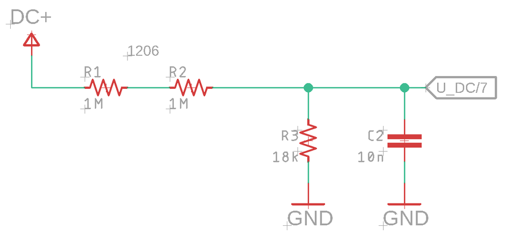

}My issue is with the channel 13 of ADC3 (PC3) - it's measuring a simple voltage divider:
Even after removing R2 and C2 the multimieter and ADC both show around 3.2V (seems internally pulled-up). When i, for example, changed pin mode to AF_OD or OUTPUT_OD the voltage was 0,6-0,8V. But if i switch back to analog the voltage goes to 3.2 no matter what. I soldered 6k8 resistor in the place of C2 to create a stronger pull-down, but that didn't change a thing...
Any ideas on what might be an issue?
2022-09-05 7:54 AM
maybe the chip is sick , by static discharge on this pin ... ? (shorted protection diode)
can you try another chip ?
or use other channel/pin for input , which is not already damaged , for a test ?
2022-09-05 7:54 AM
2022-09-22 3:15 AM
Sorry for the long time to respond, but i went with the same conclusion and switched the whole MCU with a fresh one. There was a floating ground caused by a missing 0R resistor connecting MCU ground with the one it was measuring. Thank you for the fast response and again sorry for asnwering back after so long. Have a good day!
