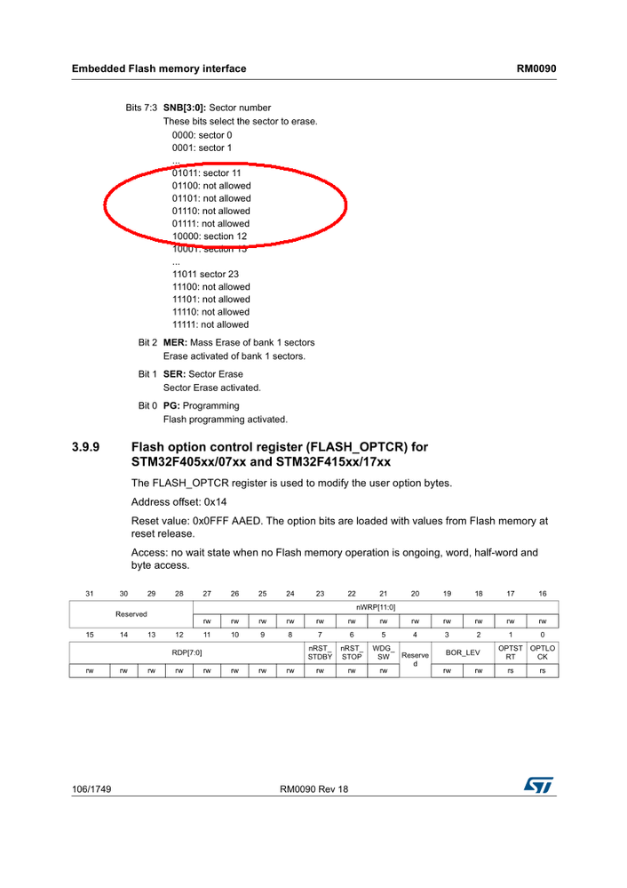

An error was found.
int OCFLASH_SectorErase(int sector)
if (sector < 0 || sector >= OCFLASH_SECTOR_COUNT)
return OCFLASH_ERR_ADDR;
if (OCFLASH_IsLocked())
return OCFLASH_ERR_LOCKED;
while (FLASH->SR & FLASH_SR_BSY) {
Bits 7:3 SNB[3:0]: Sector number
These bits select the sector to erase.
0000: sector 0
0001: sector 1
01011: sector 11
01100: not allowed
01101: not allowed
01110: not allowed
01111: not allowed
10000: section 12 (bank 2 sector 0)
10001: section 13
11011 sector 23
11100: not allowed
11101: not allowed
11110: not allowed
11111: not allowed
/* F42x, F7xx: Need to add offset of 4 when sector higher than FLASH_SECTOR_11 */
if (sector > 11)
sector += 4;
// set Parallelism Size
FLASH->CR &= ~FLASH_CR_PSIZE_Msk;
FLASH->CR |= OCFLASH_PSIZE << FLASH_CR_PSIZE_Pos;
// select Erase action and set Sector Number
FLASH->CR &= ~FLASH_CR_SNB_Msk;
FLASH->CR |= FLASH_CR_SER | (sector << FLASH_CR_SNB_Pos);
// Start
FLASH->CR |= FLASH_CR_STRT;
// as advised by the manual
__DSB();
// clear the erase action bit
FLASH->CR &= ~FLASH_CR_SER_Msk;
if (FLASH->SR & FLASH_SR_ERROR_Msk) {
ocflash_statusreg = FLASH->SR;
FLASH->SR |= FLASH_SR_ERROR_Msk;
return OCFLASH_ERR_STATUSREG;
return OCFLASH_ERR_OK;
}If the sector is bigger >11 you must increment setor +4.
Nice catch, thanks for sharing!
PS. For those who might wonder, why:
