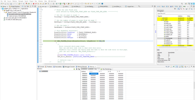

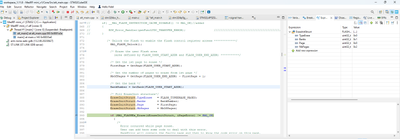

When debugging, the code hangs during execution of the following function:" if (HAL_FLASHEx_Erase(&EraseInitStruct, &PageError) != HAL_OK)", on line 377(see picture below).
In function "HAL_StatusTypeDef HAL_FLASHEx_Erase()", the debugging stops(hangs) when trying to execute the code on line 125(see picture below) and the tab mentioned above appears. It even can't enter the function on line 125(function "FLASH_WaitForLastOperation()"). When we are on this function, then press "step into", the tab with the message appears.

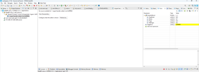

The tab with the message that pops-up(appears), see picture below:

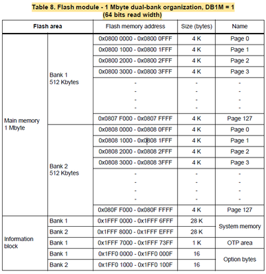

I have chosen pages(adresses) different than the MCU uses. Here below you can see(trough a Build Analyzer picture), wich adresses the MCU uses.

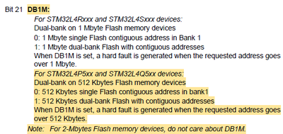

A picture of referance manual below:

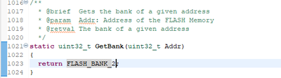

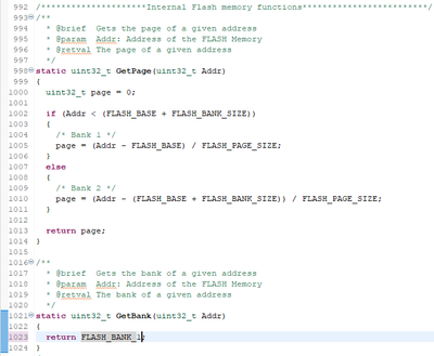

I've found my error. I must correct the return value to FLASH_BANK_2(that's why banks has value 1, since return value is FLASH_BANK_1). Picture below is how it was.
Picture(below) containing the solution(correction):
Thanks SMarie .Thanks guys. Problem solved.

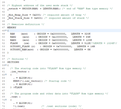

You should also change linker so that memory at 0x08080000 is not visible to it--change the flash size to 512K.
Edit: Also, is the DB1M option byte set? Check with STM32CubeProgrammer. If not, that could be the issue.

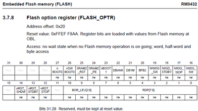

DB1M(dualbank) option byte is set, see picture below. I've checked it with "STM32CubeIDE debugger -->SFRs".
All the addresses have the value 0xFFFFFFFF, so it's difficult to check wich page has been erased(see in picture below in memory tab, the value in addresses of the internal flash memory)..

"You should also change linker so that memory at 0x08080000 is not visible to it--change the flash size to 512K"
I've changed it, but still have the same problem. See picture below, for a picture of my linker file.

"Could you show us the values of EraseInitStruct before you enter HAL_FLASHEx_Erase?"
Is it normal that i receive for "Banks" the value 1? Since i use bank2. Or does it refer to number of bank that i use?

PageError value before the crash(see picture below)
PageError value after the crash(see picture below). I think that it doesn't enter the function "FLASH_WaitForLastOperation(). PageError has the same value as before the crash.
