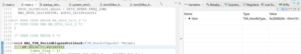

I placed the breakpoints at the callback function and timer_flag line. In the debug session, the arrow next to the line jumps to the call back function and the arrow stays at htim == him10 line every run button hit. I captured the screenshot. I don't know how many times I pressed the run button but the arrow stayed at htim == him10 line.
j is a local variable. I double checked it. Thank you @bob S and @Community member
