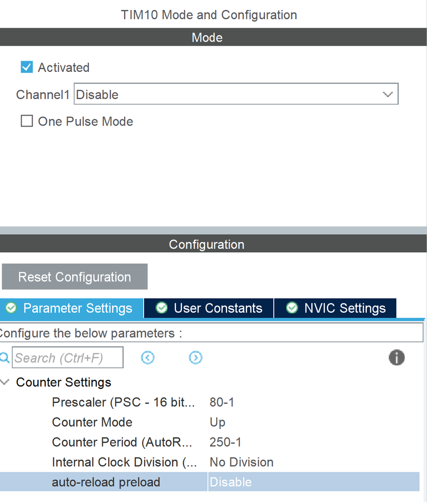

2023-04-07 1:07 PM - edited 2023-11-20 8:45 AM
I mean j variable.
The current setting of the timer is like that,

2023-04-10 9:33 AM
Do you have the TIM10 interrupt enabled in the "NVIC" tab of the timer config dialog in CubeMX?
Does your callback ever get called? Set a breakpoint and see.
2023-04-10 10:03 AM
Yes, it was enabled.
Yes, I placed a toggling command for a GPIO pin and it worked.
