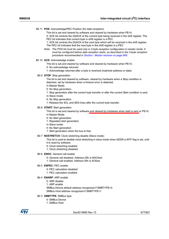

Now I able to program CR2, CCR and TRISE registers.
After that I set PE in CR1 (0x0001) and after that also set START bit (0x0101).
But read back only 0x0001.
2020-04-19 7:40 AM
Ok. I see. This bit cleared by hardware.
I see Start condition generated and bit SB in CR1 set.
Will continue.
Thank you very much.
2020-04-19 7:44 AM
I2Cx_CR1.START is self-clearing.
The whole I2C module is tricky, and it requires careful reading and re-reading both the narrative in I2C chapter, and the description of the registers/bits.
