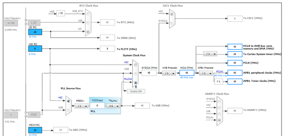

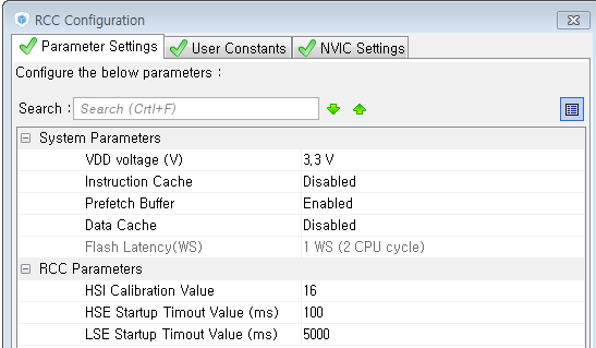

At this consideration the clock configuration at cubemx ,
During this time my RCC setting was,
Take a look here, if you feel any mismatch ,

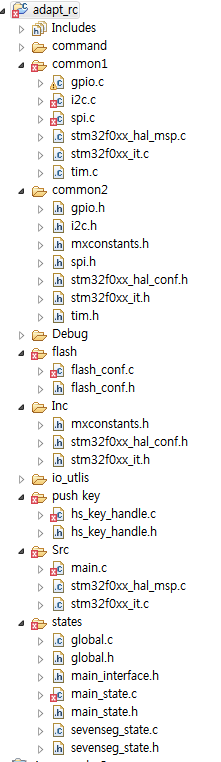

2016-12-15 10:15 PM
Ok, and where is SPI.H in the tree of files you are attempting to build?
2016-12-15 11:01 PM
Thank you sir.
Take a look all project tree. Find what you want to see.

2016-12-16 8:40 AM
I'm suggesting you use a File Manager, or whatever you use to navigate the files on your system, and find SPI.H within the file sub-directories that make up the project. Once you have found it, you need to make sure the compiler knows that path. I don't see a 'Common2' directory listed in the '-I' option in the compiler command line.
Screen shots from Eclipse aren't where you need to be looking. The compiler is telling you it can't find/open a file, you need to figure out where it is and pass that information to the compiler so it can find it too.
Not sure of the error messages in your last post, but you need to look for the first error encountered, subsequent errors may just be a result of trying to continue, so fix/address the errors in the order they occur, and rebuild as you fix each.

2016-12-19 10:38 AM
Are you suggesting to do in this way?
By 'File Manager' I mean whatever you use to understand the files and directories on the machine, to move and copy them about. I use something called ZTree as I'm familiar with it, you might use the one built into Windows.
Don't you mean keep that file after making a sub-folder under a folder in a project folder?
If I included my spi.c history at main.c, is there any problem?
Does it have any benefit to make different file under each folder ?
I mean you need to understand where the SPI.H file comes from in your project. I'm assuming it is in the same directory as the source, or in a ..\INC equivalent.
I'm not asking you to move or change anything, just understand where it is, and confirm it does exist. Don't have multiple copies of the same files.
Where there are a dozen files involved I'd tend to use a flat structure. If there are hundreds or thousands, then managing them in some more elegant directory structure will make more sense. Try to keep it simple.
Does it means if that file is unavailable then,
1. Look for it whether it added or not included file.
2. Need to find from 'search' option in whole work-space or project folder ?
Include files typically don't get added to project trees, I don't use Eclipse, but the compiler is building .C files containing source, the .H files get pulled in via &sharpinclude statements, and the system must be able to find them. If it says it can't find them, then you have set something up wrong. Most likely the include paths.
