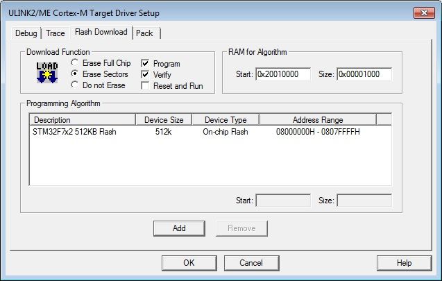

2018-10-12 11:02 AM
Pretty sure the F722 is architecturally different from the 1MB F7 products, it has 512KB and is banked differently. Different CM7 core, different die. Pick something appropriate to your chosen device. Click ADD and find the right one and delete these ones you show, cause they're not working.
This is what I'd start with...

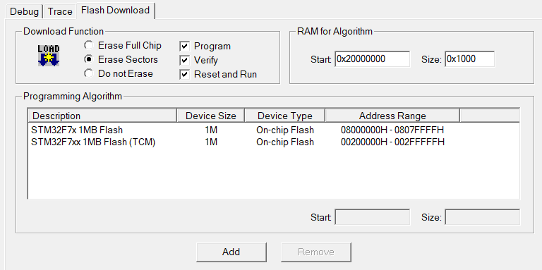

2018-10-12 4:21 AM
Thank you very much for your help!
The code size has surpassed 16KB and apparently this caused the problem. But why is this a problem? These are my flash download settings:
Shouldn't I be able to write more than 16KB memory?

2018-10-12 11:02 AM
