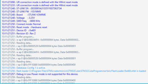

starting debuging i get this return:

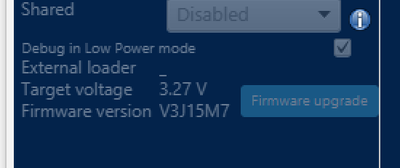

How is your board powered? The programmer does not provide power. Ensure the voltage in STM32CubeProgrammer is reflected correctly after you hit connect.
2025-08-21 1:07 AM - edited 2025-08-21 1:10 AM
Thanks for the Tip.
After I used the right File to install CubeProgrammer *facepalm* it gave me a valid Voltage and Firmware Version:

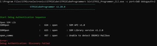

but the log tells me, i should use Debug Authentication
after a little search i found this Command Line:
Is there annything else i can do?

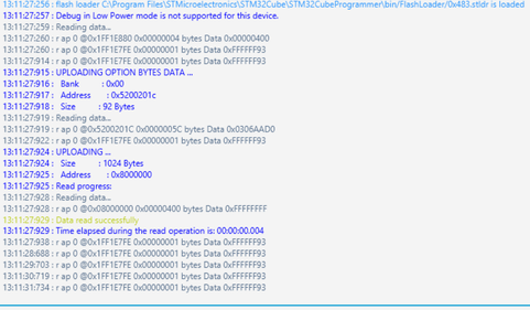

I took one MCU off the PCB, cleaned everything and soldered it back in place. CubeProgrammer actually connected and could read!
Then i tried debug mode in the IDE. It workt at first and then lost connection before it was ready for the play button. (unfortunatly lost te log of this part) I tried to reconnect in CubeIDE or CubeProgrammer with no success.
I am absolutely riddeled! Is there any false setting which could cause this kind of error?
