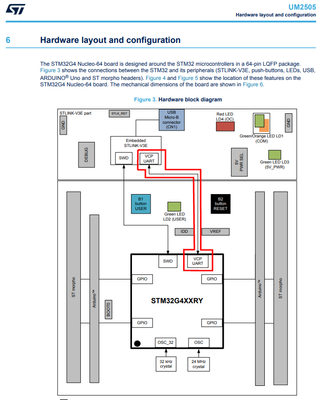

The ST-Link on the board also provides a Virtual COM Port (VCP); that allows you to communicate from a PC to the STM32's UART over USB - see Fig 3 in the User Manual:
See also section 6.6.5

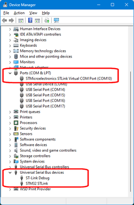

@c_shearer_cooper wrote:I can't figure out how to tell the STLink to enable its VCP
You shouldn't need to enable it - it should be enabled by default
Does it appear in your Device Manager?
