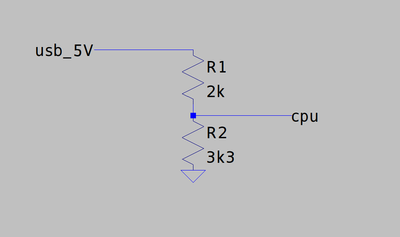

2. Never let a cpu pin float .  Better simply use a voltage divider , lets say: usb -2k - 3k -gnd ,
so at the 3k you get 3v ( = Vdd ), when usb connected. (100% save for the cpu and pulled down by 3k to gnd , if nothing connected.)
