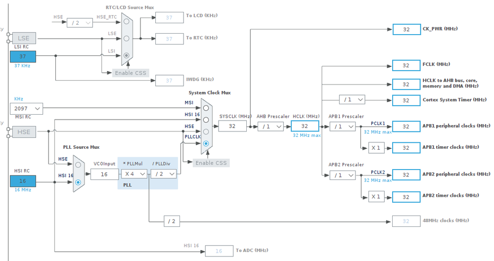

Hey guys and gals! I am facing a persistent problems when configuring system clock on the STM32L152 to 32MHz using SPL. It smoothly runs at 24MHz but always freezes when making it to run at its maximum freq.
The MCU's max clock frequnecy is 32MHz and it runs just fine when configuring the clock using STM32CUBE IDE and HAL. The intention is to run it from HSI (16MHz) via the PLL in this way:
It refuses to work in my SPL-based code, although the procedure seems to be the exact analogy to the HAL code:
