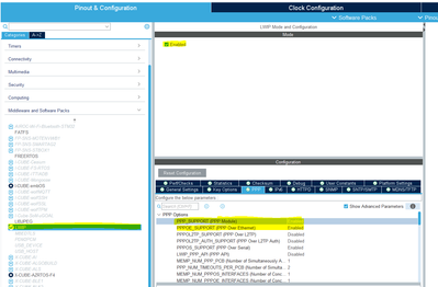

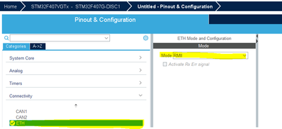

Hello @Noushadalik ,
I confirm that the steps shared in this post are developed to set PPP for STM32H747 MCU but you get inspired from these steps to set PPP for STM32F407. The DCache is not available in STM32F407.
To set PPP in STM32F407G-DISC1:
-1- Configure the ethernet as shown in the below figure ( RMII mode for example)
2- Enable LWIP
Currently STM32CubeMx do not give possibility to select LwIp Middleware without to have previously selected Ethernet. So, you can enable LWIP only if ETH IP is configured.
