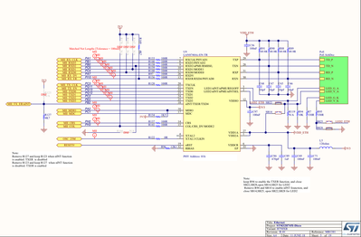

thanks @mƎALLEm for your response, i have seen the schematic its was in MII mode, i m asking do this eval board can be configure in RMII or not , if not then what are the configuration to configure ethernet in RMII for custom PCB have stm32h745bit6 controller.
No you can't configure the ETH on that board in RMII. You should configure it in MII as the board is hardwired in MII mode.
