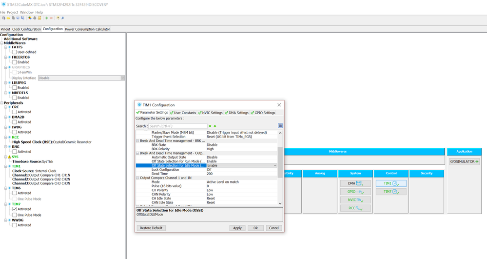

I'm trying to have complementary outputs with dead-time on CH1/CH2/CH3 and CH1/CH2/CH3N using TIM1 and Output Compare Mode on STM32F429.
So I configured STM32CubeMX like in the picture below :
And there is the portion of my code :
(for testing purposes, a button press changes the state of CH1/CH1N)

As a result,on the scope, I do get my complementary outputs on CH1 and CH1N, they invert each other when I press the button, but with no deadtime! I don't understand why i don't have that deadtime, like explained below :

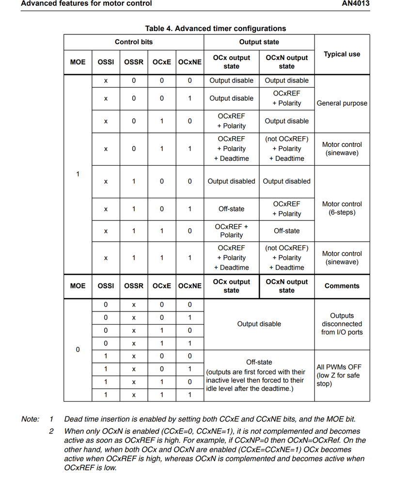

You maybe expect that there is dead time inserted when you manipulate the outputs through CCER - this is not the case; dead time is related to the OCxREF signal and that does not change when you change CCER; see the Complementary outputs and dead-time insertion chapter in RM.

Okay, so I finally found how to turn ON CH1/CH2/CH3 and CH1/CH2/CH3N with the appropriate deadtime, using CCMR1 and CCMR2 registers (by setting bits 4-6 for OC1M, bits 12-14 for OC2M on CCMR1, bits 4-6 for OC3M on CCMR2).
