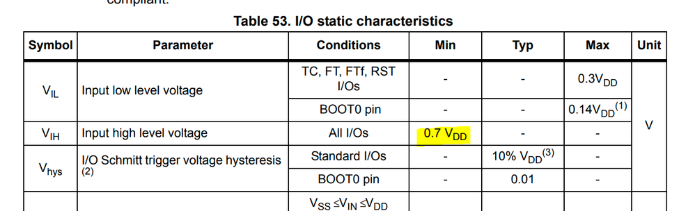

"I do not know where to check it in the STM32 datasheet"
Look at the Logic High/Low thresholds in the GPIO electrical specs; also check Absolute Maximum ratings.

> Would the STM32L031 SDA and SCL be compatible with an input high level of 1V8 maximum (i.e. the host VDD) according to the STM32L031 VDD=3V3?
1.8V is not guaranteed to be logic high on a 3.3V system, so it is not guaranteed to work.
2.31V is required for logic high on a 3.3V system. 1.8V is not guaranteed to be high or low.

Dear TDK,
I do thank you for your answer. It was also my reading of the datasheet but since it seemed to work well even though when I stressed it a lot, I had doubts.
So OK : To fully guarantee it I will add a level adaptation between 1V8 and 3V3 domains for both SDA and SCL lines.
