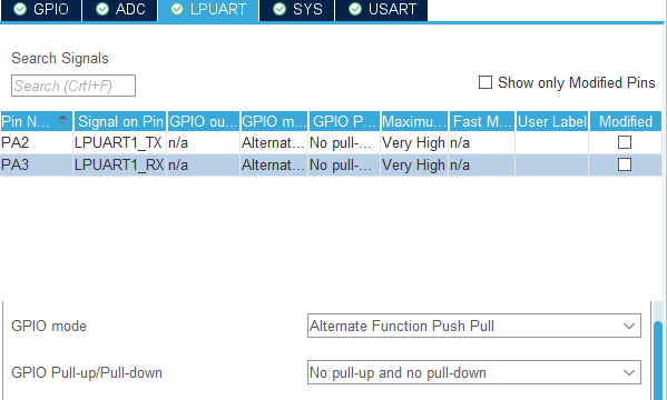

2023-05-07 10:44 PM - edited 2023-11-20 6:12 AM
Thanks @KnarfB and @Community member for your valuable comments.
Should i use the pull up setting that comes with the UART configuration itself (As mentioned in the image below) or should if configure the pin as input with a internal pull up before UART initialization.
