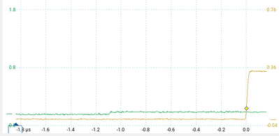

Below you can see the INP in green. Negative is 3/4 refint voltage. You can see a slight bump in INP that I assume is due to GND shift from the COMP drawing a bit more power? Anyway, not enough to properly trigger. Yellow is the COMP output.
This happens only at start but no false triggers afterward.

On the waveform you've posted, at which point does the false EXTI happen? Isn't rising edge interrupt the expected one there?

The rising yellow trace is the output of the comparator. The green line is the input. At no point does the INP go high so there should never be any COMP detection. This happens right at enable.
