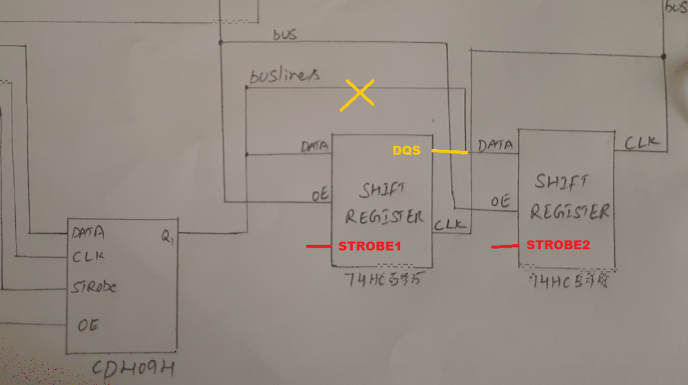

Hi Experts,
PFA the hardware design. I am trying to send data to parallel (not cascade) 74hc595 over common bus lines from CD4094B. I am sending 16 bits to place first 8 bits in 74hc595(1) and second bits in 74hc595(2). But I am getting same 8 bits (10101010) on both 74hc595 devices.
Could you please let me know how to send 16 bits such that first 8 bits should place in first 74hc595 and second 8 bits should place in second 74hc595. Please find the code snippet below and let me know if I am missing anything.

2022-01-02 8:37 AM
Sorry, I would have confused you saying that 595 connected are in parallel. But they are neither connected in parallel nor serial (cascaded) and connected through bus lines (Data, clock, latch). As you have mentioned all the ICs are connected with 1.2.3. My program would be wrong. So I am trying to get some help to code in correct way. Please help me if you are able to understand the hardware and guide me.

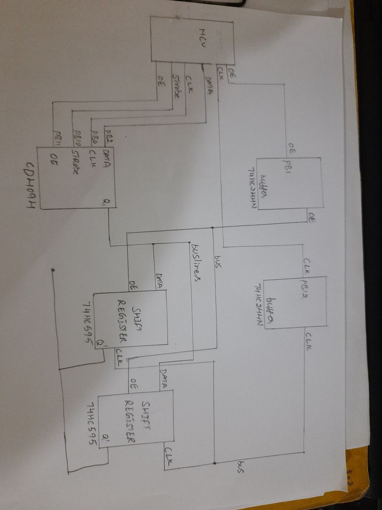

2022-01-02 9:15 AM
For 595, Pin 12 (Clock i.e., RCLK+SRCLK) connected to MCU via buffer (74hc244n).
For 595, Pin 1 (OE) connected to MCU via buffer (74hc244n).
595 is receiving clock, OE and data (from CD 4094) is receiving via bus lines.
For CD4094, Pin 0 (clock), Pin 11 (OE), Pin 2 (Data), Pin 10 (Strobe).
There are 2 clock signals, one for 595 and another for CD4094 and same for OE as well.
PFA the schematic. Please let me know if you need more info.
2022-01-02 9:35 AM
For 595, Pin 12 (Clock i.e., RCLK+SRCLK) this is primary fail, you 595 never write clean data because you connect serial clock and register latch write together. Ok you use delay with R 39k and C 0,68uF ,but this isnt clean use. Too you alltime set outputs to tristate with OE. This is used only ...
BUT ok i read your schematics better and now understand CL1-8 is same circuits with 595 usw.
Every bit on CD out is one data input to CLx , then code need change ...
BUT now seems you need write 8x 8 bits and not only 16 bits ?
2022-01-02 10:05 AM
Try this

2022-01-08 3:30 AM
We have changed the hardware design as per your suggestion and it is working as expected. Thanks for your help and support
