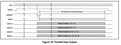

2025-08-21 6:00 AM
Hello @KDJEM.1 ,
thank you again.
The ADC datasheet does not mention QuadSPI specifically. It shows the following graphic in the datasheed.
This implies a version of QuadSPI that does not parallelize all data but splits the channels to different lanes.
Is there a memory format/setting for the QSPI or OCTOSPI interface, that adheres to this data format?
From what I found the forum post on QSPI memory as well as RM0468 section 25 this is not intended. Is this correct or am I missing some function?
Best regards
Marco
