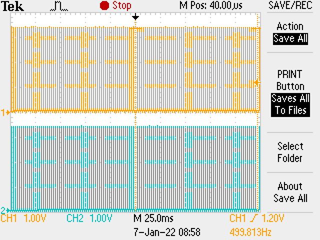

Example with digital output not working as expected:
Code in main() while loop with no interrupts, and no RTOS
HAL_GPIO_TogglePin(GPIOB, GPIO_PIN_0) is called 2 times with no delay in between
GPIO_PIN_0 (PB0) does not toggle when it should
PB0 toggles a small random number of times (example: 4 times) then there is a large random length delay (can be hundreds of ms long)
GPIO_PIN_0 (PB1) works as expected because it is separated with delays
Channe1 = PB0, Channel2 = PB1
The main loop is called every 2 ms so the yellow trace (GPIO_PIN_0) and the blue trace (GPIO_PIN_1) should toggle each time through the main loop, but the yellow trace is not toggling when it should.

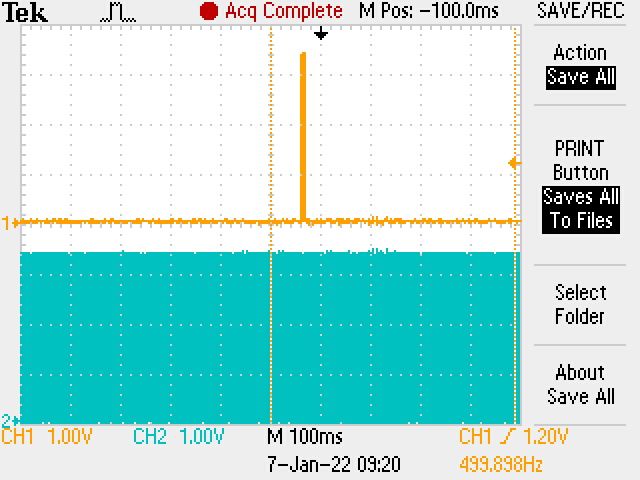

If there are two statements of HAL_GPIO_TogglePin() immediately following each other or 2 statements of HAL_GPIO_WritePin() following each other then the output pin will toggle a few times as expected and then stops responding for a long random period of time (hundreds of milliseconds).
It seems that I need at least a 1 ms delay between the statements that change the output pin state or the output pin stops working correctly. I have tried small and large delays using HAL_Delay() in the main loop, I tried using osDelay() in a task, and I have tried creating my own microsecond delay function, but the output pin does not respond as expected unless the delay is at least 1 millisecond long.

1. Set the highest GPIO_OSPEEDR setting for given pin
2. Switch oscilloscope to its highest resolution - it won't sample ns at 100ms/div.
