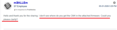

You've previously shared that project but my question was:
So please clarify how you measured the clock frequencies in the firmware attached.
