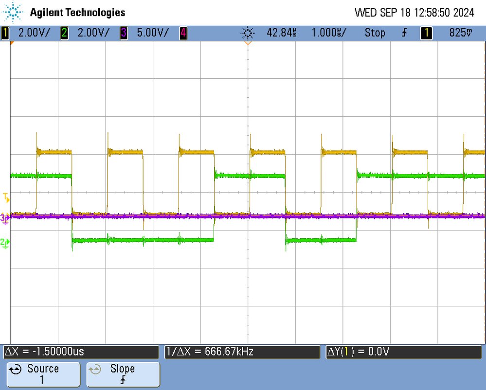

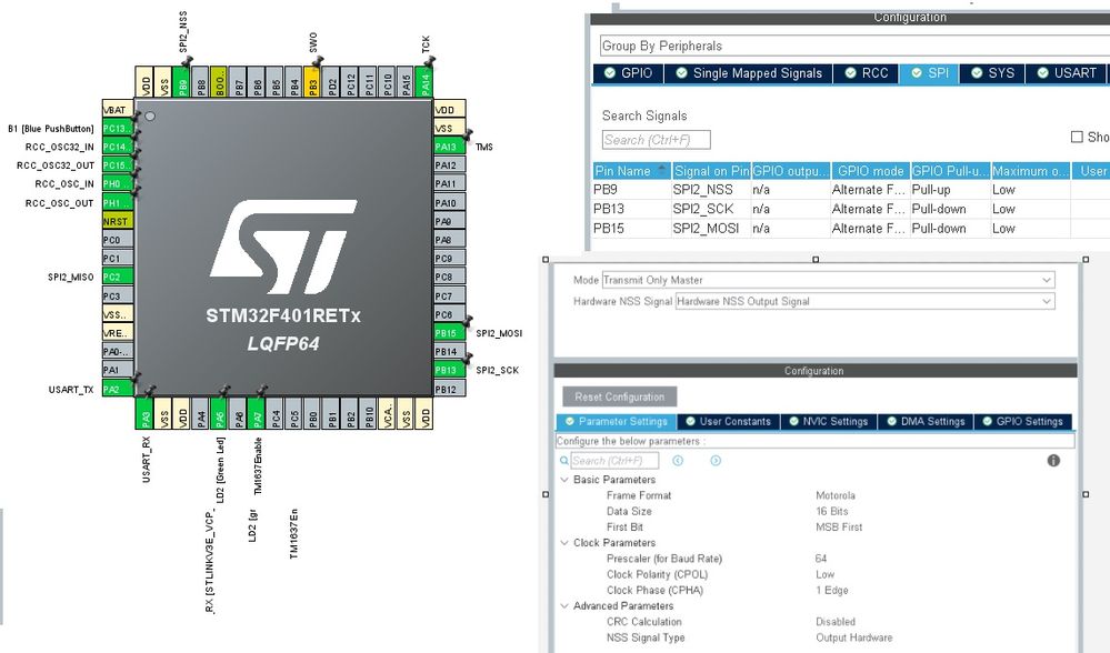

I m having an issue with my Nucleo F401RE. I m porting a code based on the use of SPI2 that worked very well on Nucleo G431RB. I made same setting on Nucleo IDE (see picture).
After inizialization of periperhals NSS (Chip Select) goes to high and everithing seems to work fine until the first transmission:
void SPI_TX_16b(uint8_t* pdata){
HAL_SPI_Transmit(&hspi2, (uint8_t*) pdata, 1, HAL_MAX_DELAY);

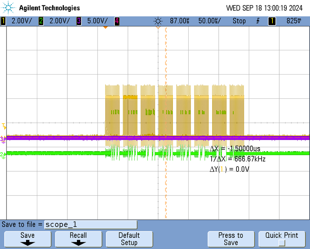

Then the NSS goes down and stucked there forever. In the picture (yellow is clk, green is data out, and violet is nss).
Any ideas?
Thanks

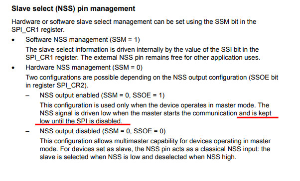

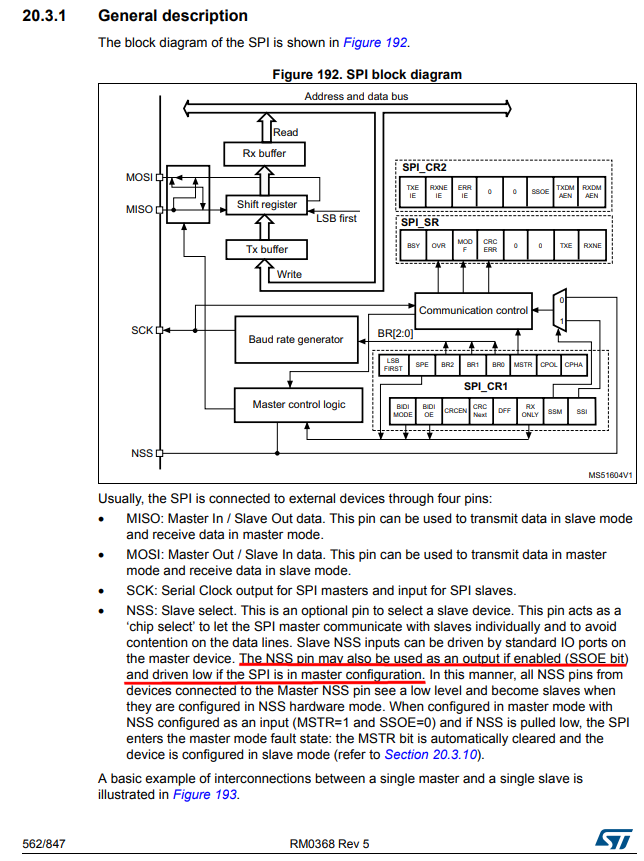

The behaviour of the "hardware NSS output signal" is described in the Reference Manual:
Indeed, that doesn't sound like a very useful behaviour - but it is the defined behaviour.

Unfortunally it doesn t work as described in the Reference Manual. I have to add manual CS meaning that I have to add layer of software (simple modification) over the HAL.

@FAJOL.1 wrote:Unfortunally it doesn t work as described in the Reference Manual.
Doesn't it?
@FAJOL.1 wrote:Then the NSS goes down and stucked there forever
That is the behaviour described in the UM:
So, if you want it to release NSS (from the low state), you need to disable the SPI.
