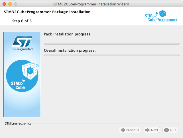

I'm having troubles installing STM32Cube Programmer under MAC - High Sierra, recently formatted.
The installation process starts regularly and then freezes forever!
Can anyone help me??

Can you please give us your java version ? java -version and please indicate in which step you are observing the freeze.

Here's the output of the query.
java version ''9.0.1''
Java(TM) SE Runtime Environment (build 9.0.1+11)
Java HotSpot(TM) 64-Bit Server VM (build 9.0.1+11, mixed mode).
The installation freezes at the very beginning.
Thanks in advance for your support:-)

Java9 is not yet supported by MAC installer. You have to install java8 if you want to use STM32CubeProgrammer.
