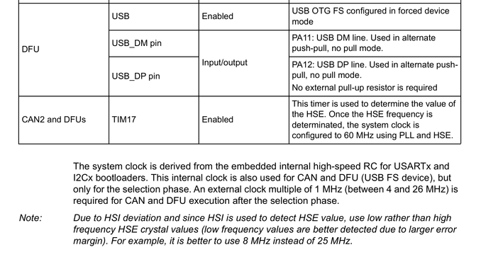

Are you sure you design meet AN2606 USB on PA11/12 and HSE as noted ?
2025-06-05 11:34 AM
Yes, both PA11 and PA12 are using push-pull mode, the fact is the USB DFU loader works just fine if I go into my JumpToDFUBootloader() function and hold the BOOT0 input high which is what I am trying to avoid using or if I do a reset and hold the BOOT0 input high
