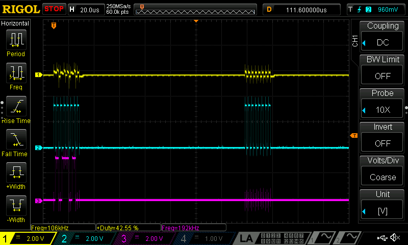

To that end, I am attempting to attempt to read in the bootloader via SPI on an STLink V3.
I am successfully able to do so for a NUCLEO-L496ZG, but fails for a NUCLEO-U575ZI-Q.
This is what the traces look like on the Oscilloscope. Yellow is the MISO line.

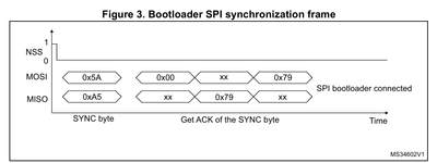

The trace shows two bytes, not enough for a sync frame. Can you show the full sequence? Would be better if you controlled NSS as well, showing the full 4-byte sequence.
Edit: Eh, I guess it should transmit 0xA5 on the first byte regardless.
2025-06-06 5:23 AM
Exactly, I can show all the traces but didn't want to spam the question needlessly. The L4 shows a perfect 0xA5 on the first and second byte, but all of the response on the U575 MISO line looks like the image I added.
