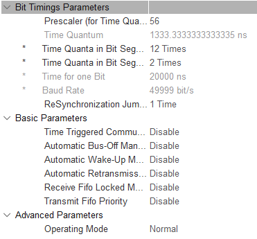

For the F407 all TX & RX events are triggering (reused old working code) the CubeMX settings (HCLK 168 MHz, periphiral clk 42 MHz) are:

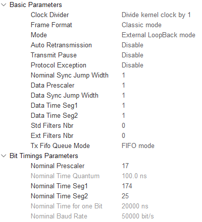

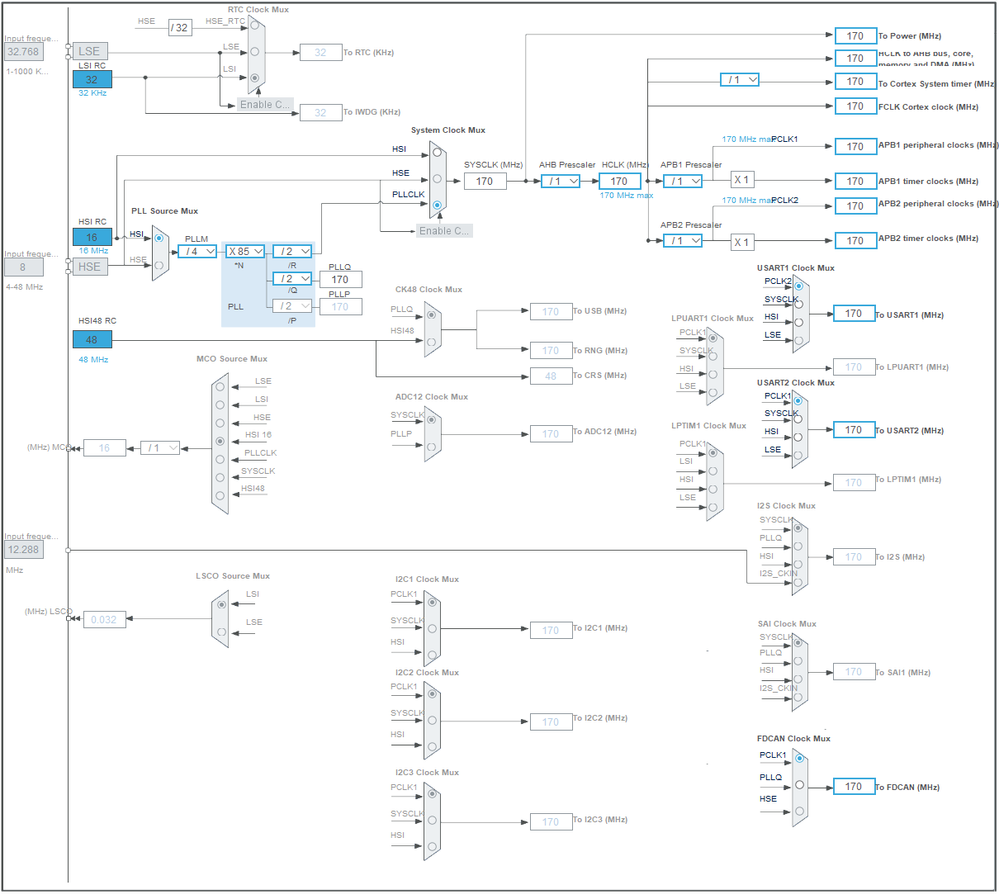

The G431 is not working as expected, the CubeMX settings (HCLK 170 MHz, peripheral clocks 170 MHz) are:
The G431 TX/RX interrupts are working only in external Loopback mode in normal mode nothing triggers. Some code for the configuration of the G431 CAN:

Indeed, there is no crystal on the NUCLEO-G431KB board but you can use STLINK-MCO output as clock source from the STLINK. The STLINK is already clocked by a Crystal. And from G4 you need to configure HSE in Bypass mode.
As that NUCLEO board feature STLINK V3, STLINK -MCO output frequency value is configurable.
Please read this article: How to use STLINK-V3 MCO output on Nucleo boards as a precise clock source for STM32

You configured the FDCAN interface in Loopback mode for STM32G4. You need to change it to Normal mode and Classic format.
Also you need to use a crystal for CAN peripheral for both F4 and G4. Avoid using HSI and other internal RC sources.
2025-05-05 1:43 AM
The hardware that I am using is:
- STM32F407G-DISC1; there is a crystal HSE is selected
- STM32G431KBT6; there is no crystal on the board; the clock setting is as follows:
In switched between Loopback External and Normal Mode for the STM32G431KBT6
If I run the G4 in Loopback external, the TX & RX interrupts are triggered correctly (functions HAL_FDCAN_TxBufferCompleteCallback(...) and HAL_FDCAN_RxFifo0Callback(...), see code example initial post). Also the receive interrupt at the F407 is triggered; I can see the data while debugging the F407 with CubeIDE. Furthermore, I can see the bits on the oscilloscope.
If I run the G4 in Normal Mode no TX & RX Interrupt is triggered, the F407 is still connected to the bus for that hardware setup. Seems that nothing goes out on the TX line.

I switched the clock configuration of the G4 to HSE, STLINK-MCO. Some changes in my code and filter configuration was necessary, now both devices communicate. Some code snippets for the community...

Both devices are configured with 50kbit/s.
